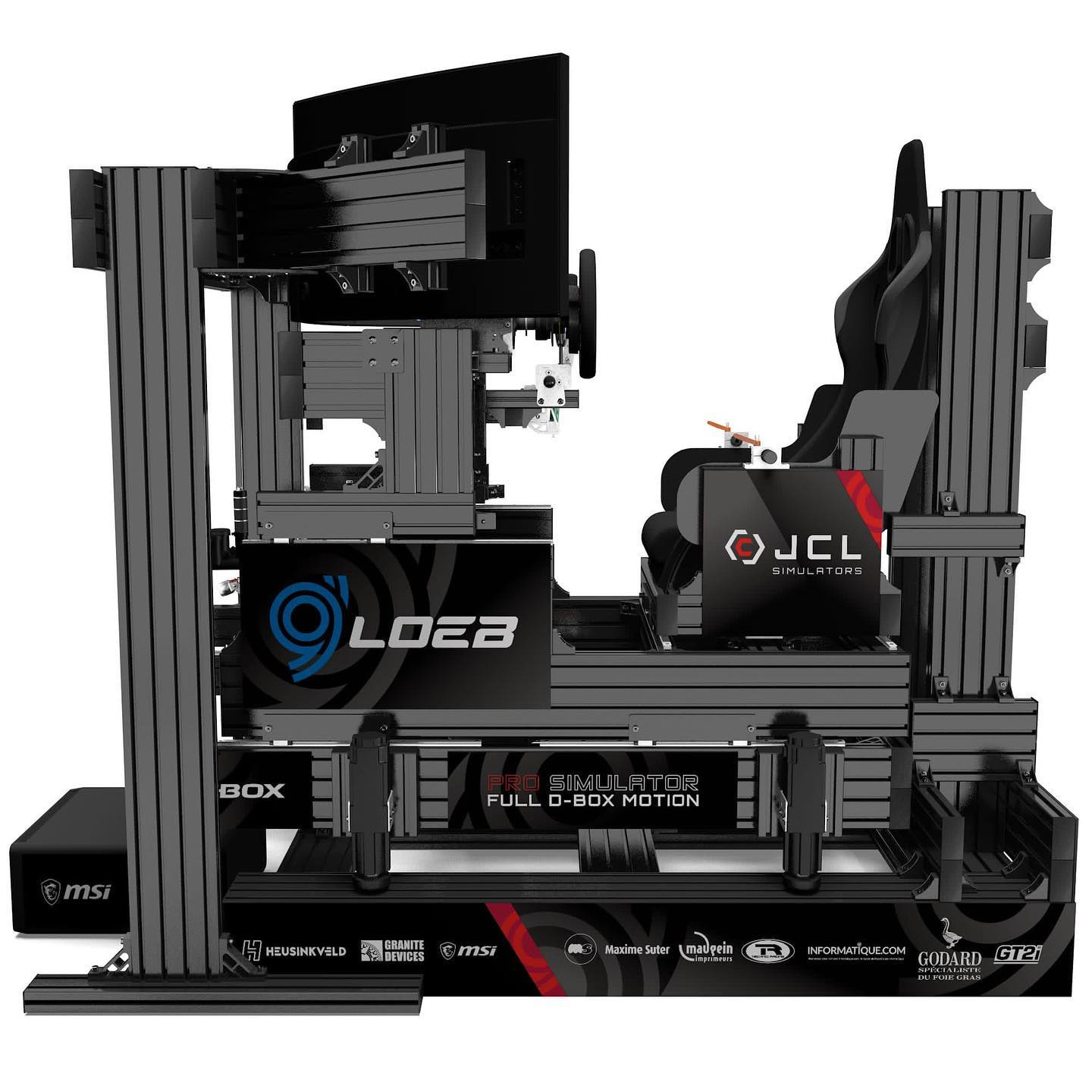

For me? Gotta have some D-BOX of course! If you’ve kept up with our social pages recently you’ll have seen the insane 6 actuator setup from one of our partners!
  • Triple Curved screens
  • 4 D-BOX actuators for road feeling
  • 1 D-BOX actuator for Surge (moving forward and backwards)
  • 1 D-BOX actuator for Sway (moving side to side)
I’d say that’s a pretty good place to start!

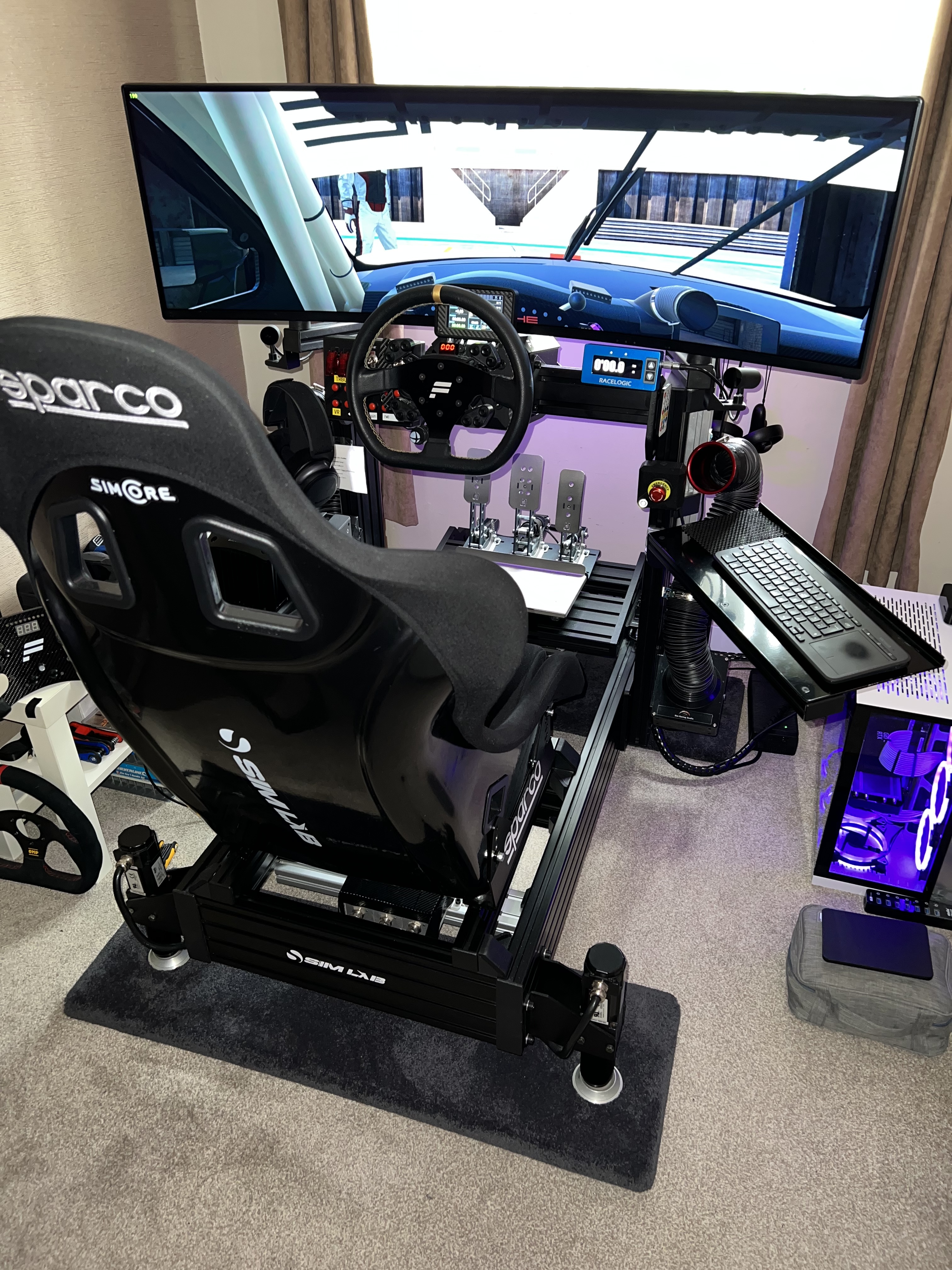

My setup is pretty good. 4 d-box actuators on the corners. Direct drive, lots of bits and bobs. Would actually love a little more travel that the small travel but I’ve spent all I can !
Love it !
Hey Colin,
Move your actuators closer together. It look that the distance is too long.
I have about 610 mm from side to side and 620 mm from back to front.
Plenty of movement with this distance (pitch and roll).
Amazing setup!!
Good suggestion - I’ll try but I think that they are quite close already to the wheel upright. I will check though.
Appreciate the feedback

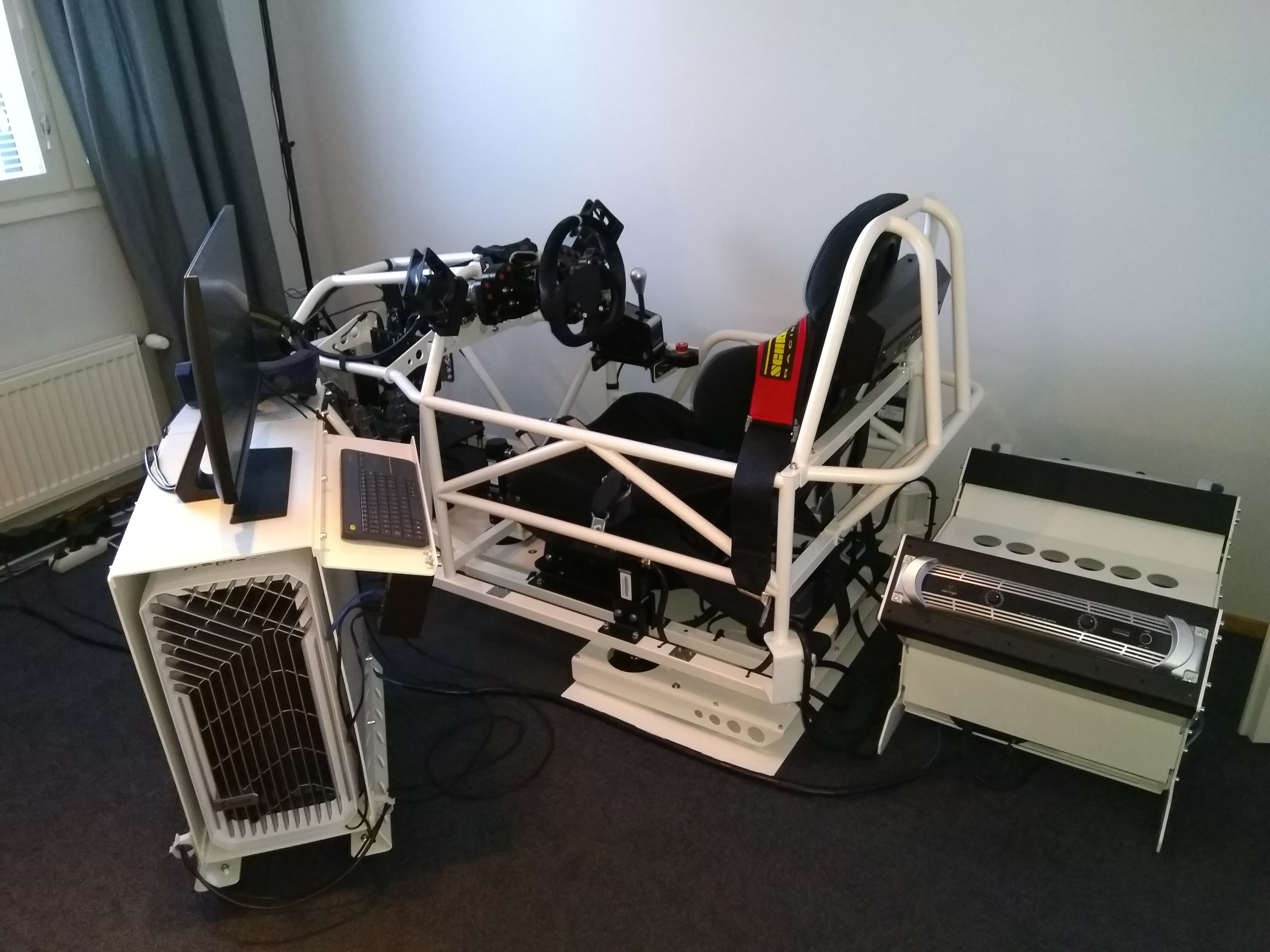

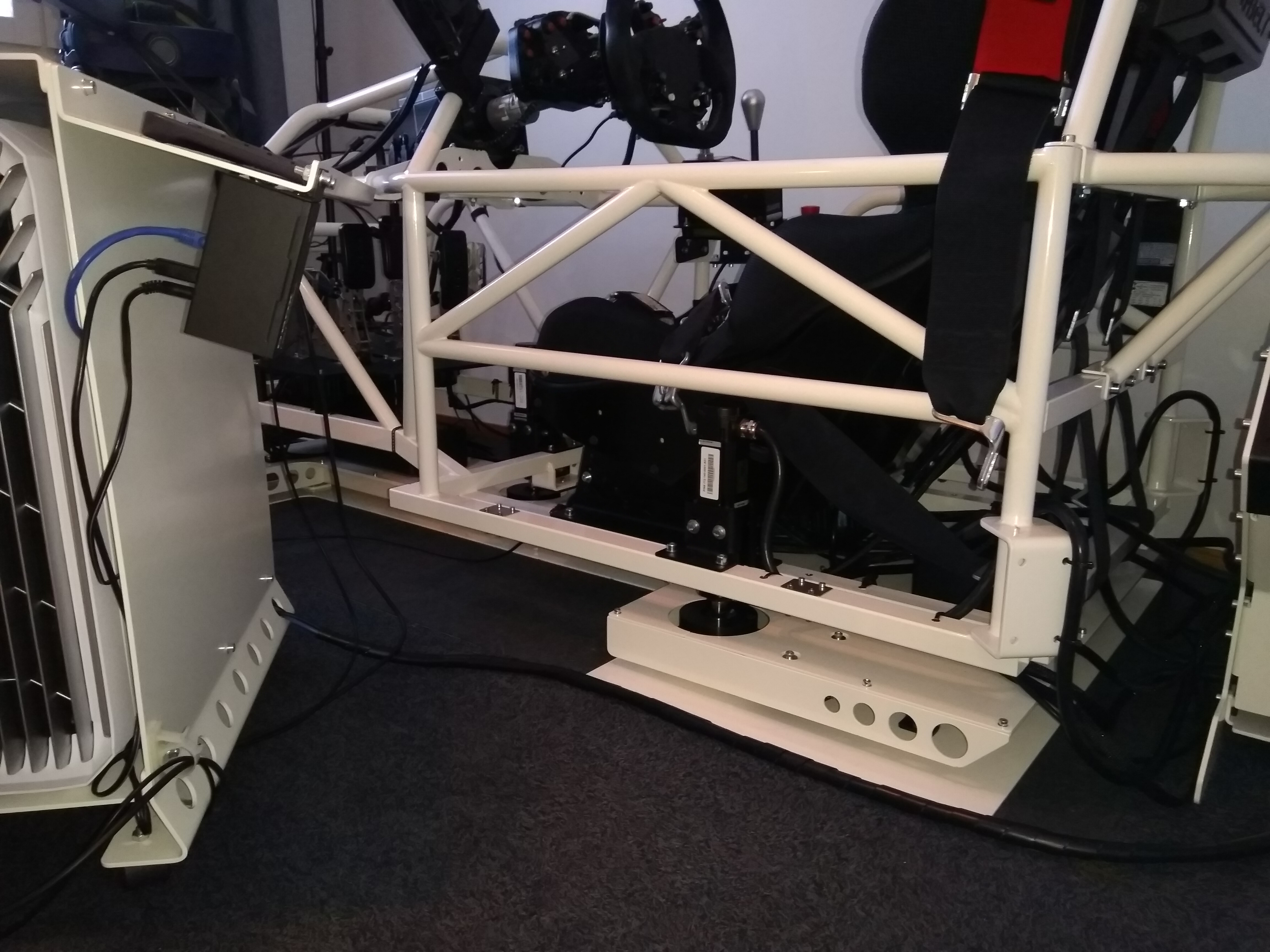

Here few pics of my rig where you can see how I have placed my actuators.
